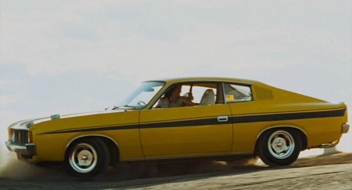

It looks really cool in yellow with the tinted windows.
Are you going to do any black stripes or anything? not like a Tiger stripes but something cool like the Chargers or Cudas had.
